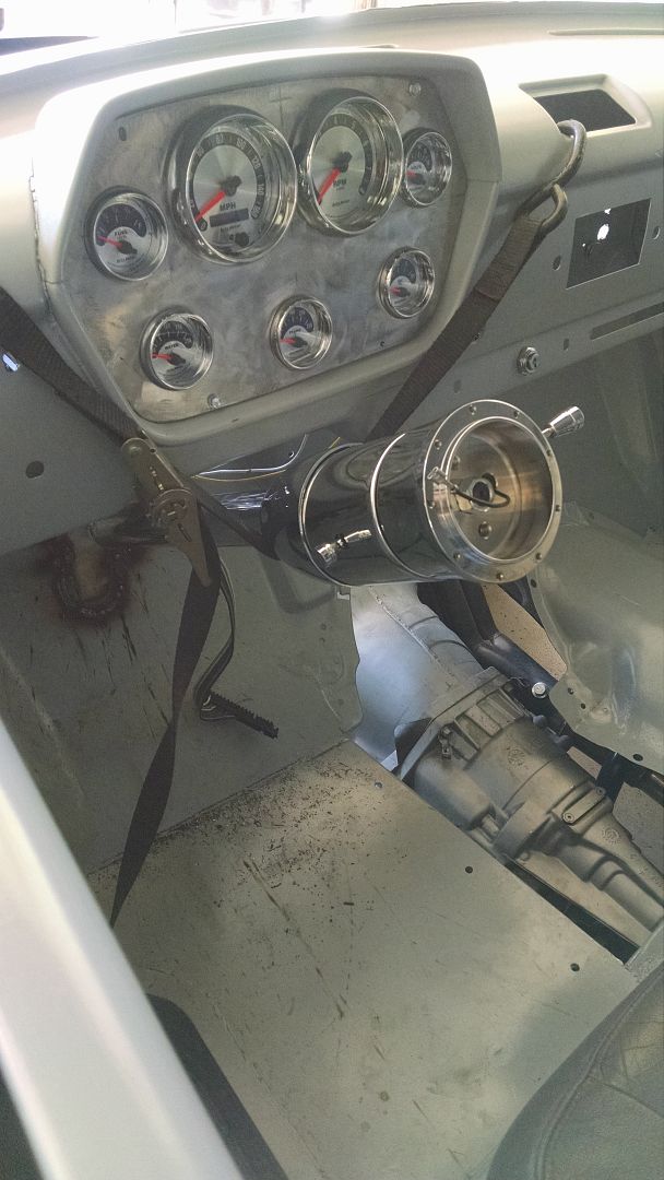

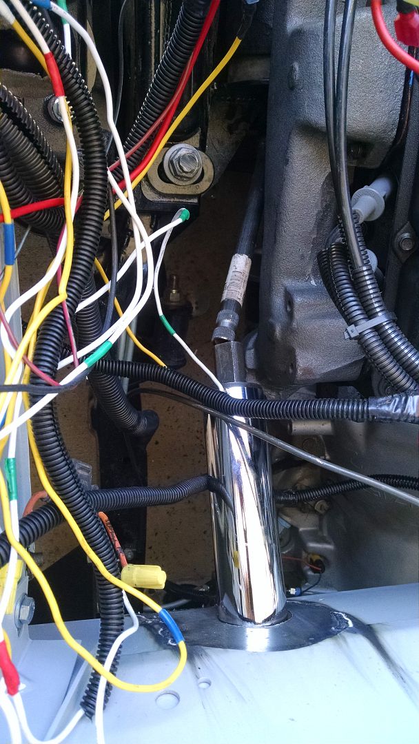

gauge pod complete , started on mock up of the steering column . had to patch in the original hole and drill out a 2-1/8" hole for the new column , had to go back to oem exhaust manifold because steering shaft would not clear long tube headers

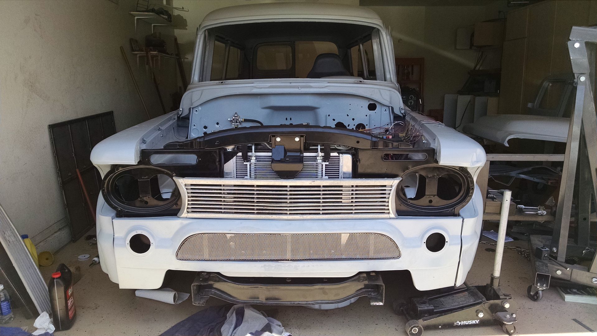

made a frame up for the lower section so i can install perforated mesh

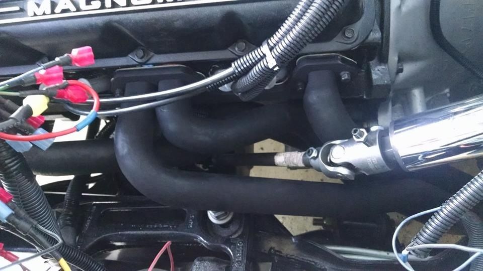

i was able to keep the long tube headers , had re route the primary tube to clear the steering shaft 65 town wagon project - Page 2 Header%20mod_zpsuokpfhqm

Post by 70chall440 Fri Sep 25, 2015 12:33 am
seems to be a universal problem; steering shafts and headers...
