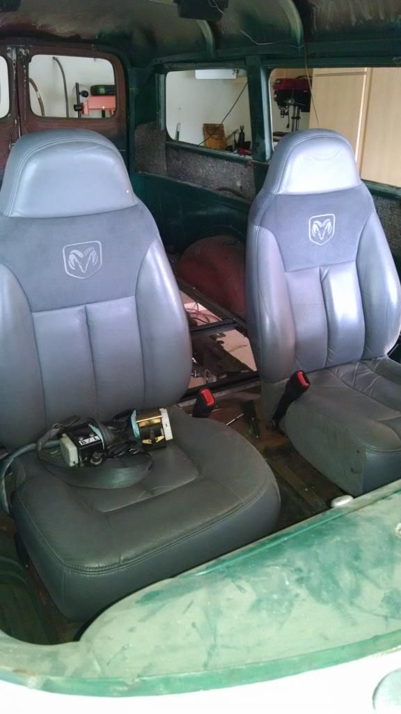

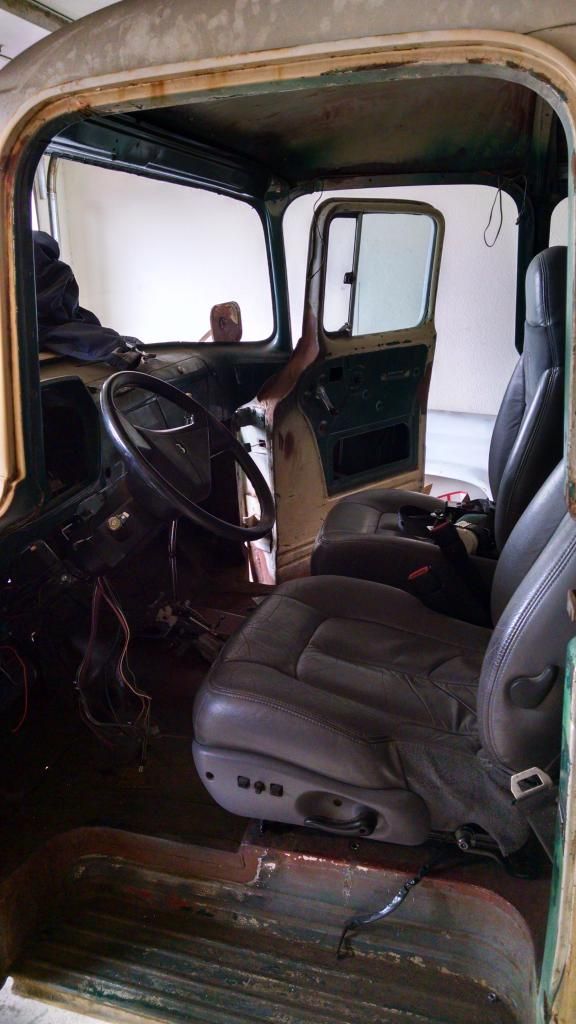

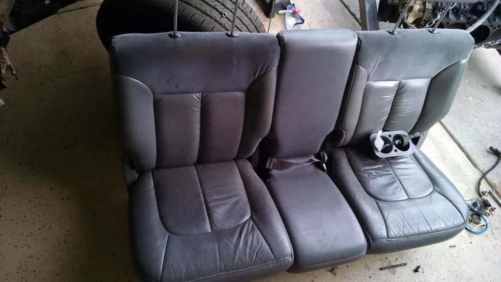

Took Natalie to the jy today to find some seats and think we came out with some decent ones , also pulled the e brake foot pedal assembly and cable. Once we got back , put the engine back in to test clearances for steering once everything checked good got the steering pretty much done
[/IMG_20150214_185352884_zps0e31ac95.jpg.html][/URL]
