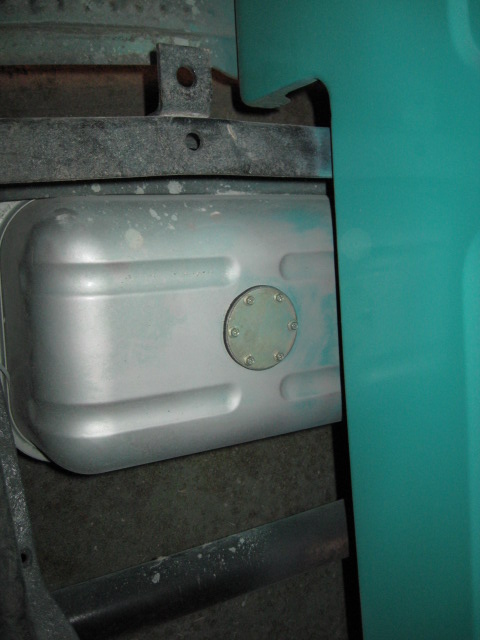

Tanks Inc makes a '47 tank that will work if you make custom brakets
