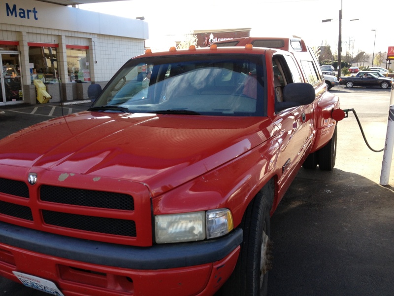

Sorry for being absent, after my last trip I embarked on another "interim" project which is extending my shop by about 6 feet. Doesnt sound like much but turned out to be a lot of work. I about got it wrapped up and am re-running my air lines and then I should be able to put everything back and get back to work. During this event, I decided I needed yet another Dodge truck and more specifically a diesel dually. So... I begin looking and after many failed attempts finally found one that I thought was worth buying; it is a 98 2WD dually that seems to run really well, had the lift and injector pumps replaced and the trans rebuilt about 100K ago. Upon getting it home I then took stock of what I had obtained and begin to notice all of the little crap that was wrong, broken, notworking or missing. After several trips to some local scrap yards I got her somewhat sorted out.
This is my first diesel and I have a bit of a learning curve, but it is coming along. I just spent about $1000 on some needed parts and accessories, so we will see how it pans out. I do need a passenger side dually fender though...[img]52 Dodge B3B Hemi Project - Page 2 Img_0910[/img]

Post by rich Sun Apr 07, 2013 7:22 pm
looks like a nice find
