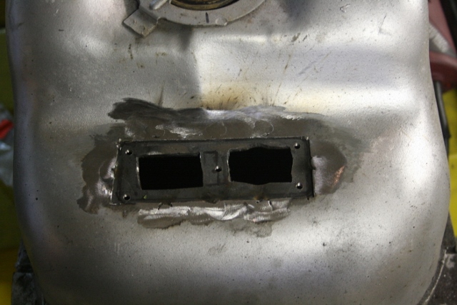

I cut out the opening and then made a backing plate with a top plate, which is screwed down with 5 8x32 screws.

[img]52 Dodge B3B Hemi Project - Page 8 Oct_2819[/img]
this is my pickup, it is 3/8 mild steel. I counter bored the AN fitting so it fit snugly into it and then welded it in.

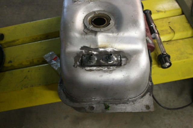

[img]52 Dodge B3B Hemi Project - Page 8 Oct_2821[/img]
Here it is all done. I will cap off the return line until I install an EFI system (should I decide to do that).
