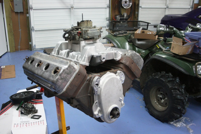

Here is the engine that is going in it. [img][/img]

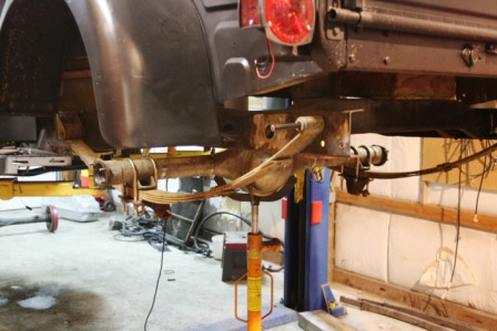

Re: 52 Dodge B3B Hemi Project
Here you can see where I extended the frame 2" due to the rear sliders. I am going to install a rectangular cross member between the frame rails to add strength and then build brackets for the rear bumper off of that.
[img][/img]
[img][/img]

I plan on putting in a tilt column and a cool steering wheel. If all goes well and I am fall in love with it (I like it, just not sure I love it), I will put a sterio and some speakers in it as well. I want to put some type of sound deadener in it just to quieten the "tinnieness" of it. I am thinking of using a spray on product like bed liner or perhaps lizard skin, but we will see. The over riding principle behing the truck as been "low budget" and have stuck to that with the exception of th engine, although I just did a rebuild on it and did get a few "cool" pieces such as the aluminum intake and timing chain cover. Other than that the engine is 30 over and just a rebuild. The cam is a little hotter than stock and is a regrind, the push rods are adjustable (due to the reground cam). The trans is a SB 727 out of my Cuda project and has a recent rebuild on it. I did buy a suregrip pack for the rear end and will be running 3.55 gears.
