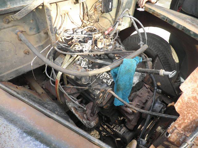

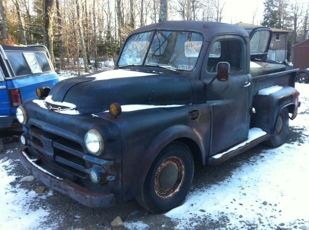

Well I've been waiting to post this until we started making decent progress so here it is. I've been planning this thing in my head for a year or so and alot has changed but I'm still hoping it turns out alright. This is my first build and I wanted to keep a log of my progress so I hope it isnt too boring!

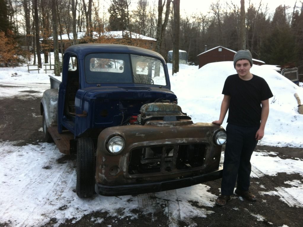

Here is basically what I started with...
The original plan was too lower it a bit and get it moving highway speed with the old flathead 6. While of course updating the brakes.

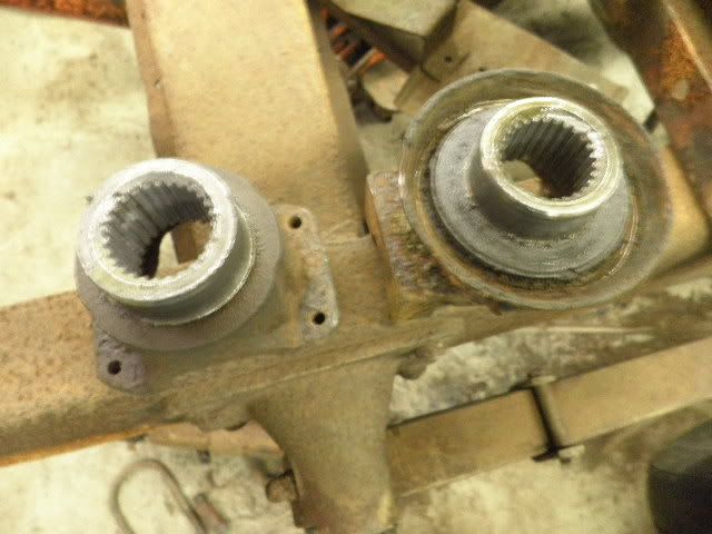

Soooo... First thing we did was get a dropped axle from Sid along with new king pins. It was a little confusing at first but we cut up another pack of leaf springs to make crude spacers. This dropped the truck down and gave it a slight rake. I will post a tech write up of the drop axle installation if you guys would like, it is quite confusing working your way through it on your own, but it should be a breeze if you know what you're doing! On to the engine, like I said the original idea was to run the flathead with a t-5 behind it but when we took the head off there was a big chunk out of one of the cylinders. We tossed around the idea of putting a big block flathead 6 in it but then my dad suggested an old gmc van our neighbor had. He asked him about it and he said if you can get it out of here, you can have it. So that is the explanation for why it has a Chevy engine. I don't mean to sound like an asshole but I don't care what anyone thinks about the small block chevy, it was free, parts are cheap, and it is one of the most traditional engines out there. So it is staying, if you don't like it hit that big red X in the top right of your screen.

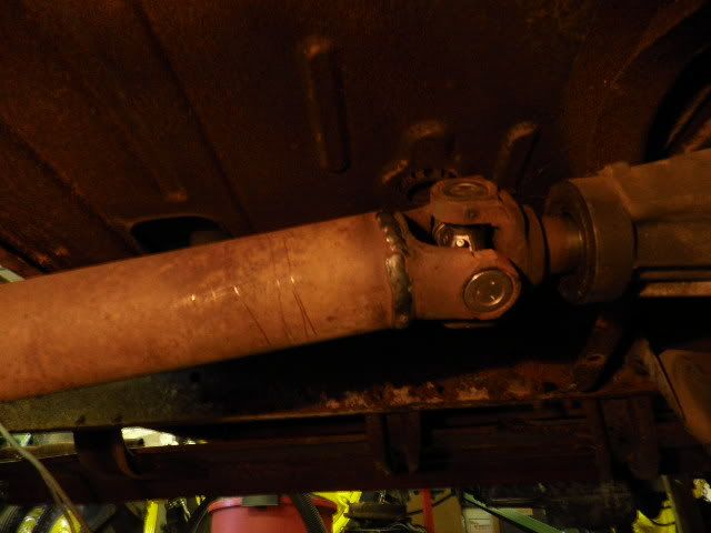

Its a great fit, same as original. As for the driveshaft I had a 90 Dakota driveshaft at hand which also had a larger universal joint than the Jeep so I decided on that. Jeep on the left, Dakota on the right...
The Dakota driveshaft was a few inches too long so we cut the end off and welded the chevy slip yoke in the other end.
And there you have it a one off th400 to Jeep driveshaft for exactly $0. Just to keep it in perspective at this point in the build there may be $300 in the running gear minus the front end that was way more...

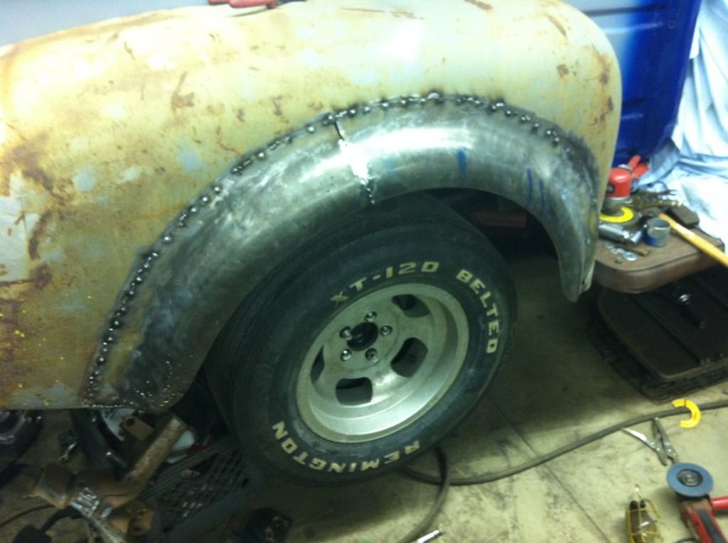

Now onto the sheet metal repair/ modification... I did a lot of patching on the bed and also got it ready for an oak floor, I was dead set on re-radiusing the rear fenders with the front fender opening. If you followed my original thread, these pictures won't make much sense to you because they are pretty out of order. I am only posting them this way so I can show the start and finished product together....
Thats the basic idea....
And the finished product before metal finishing...

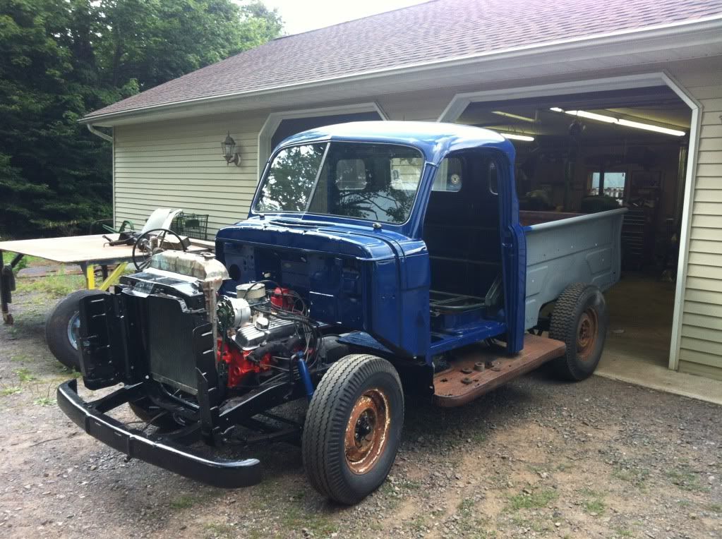

I have been making a TON of progress recently including getting my front wheels painted, and mounted with brand new firestone whitewalls and my full hub caps. I am also in the process of finishing up the rear panel and doing the body work on the whole truck. I will try to get more photos uploaded to continue the thread if you all would like. As for now that is the birth of "The Gray Nosed Goat" coined by my buddy nikkyp. Thanks for checking it out and wanting me to post my build on your site!

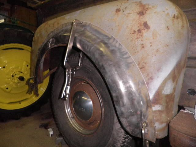

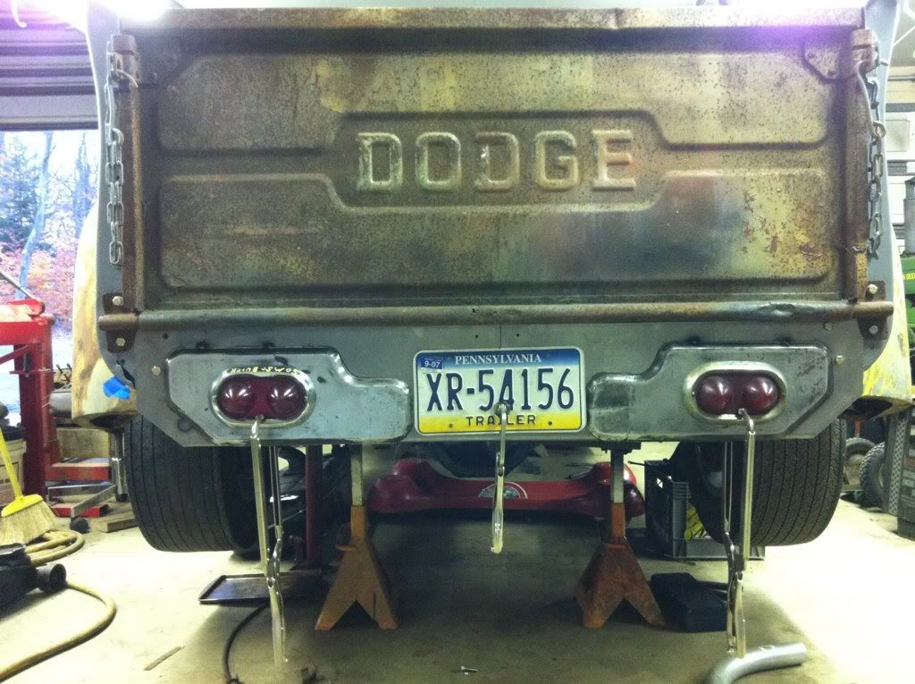

I wanted to use buick tail lights real bad so instead of just slapping them on I came up with a custom panel under the tailgate. I love the look of it, the picture is only of the mock up because I still haven't finished it yet but I am currently working on it.

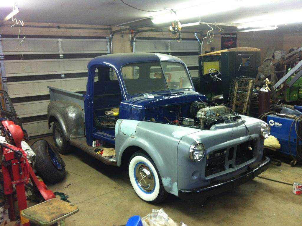

Here is what the rolling stock will be looking like... Powder blue wheels, 3 1/4 white walls, and the most under rated hubcaps around, guess em if you can mopar guys!
And mounted up they look absolutely killer...
I am aiming for an early 60's feel for the truck and I trying my hardest to visibly not use any parts newer than 65. But I think I am hitting the mark, the wheels really put a little pep in my step to start knocking out the bodywork. Probably the only thing I haven't messed with is the nose, I was holding out for a 54 Nash Ambassador grille until I found a '54 Dodge about a mile from my house. I talked to the owner a number of times and tentatively the truck is mine he just wants to get the driveshaft off it for a hemi powered Model T he is building. So I am currently waiting for the call to go and pay and pick up the truck to make finish the grille. I have plans for shortening the bottom 54 grille bar and just fitting it into the 53 opening. I have this crazy idea to chrome them when I'm done, hopefully another buddy can come through with some reasonably priced plating so I don't have to take out a loan...

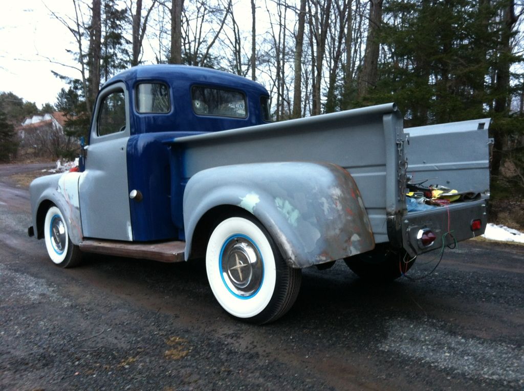

Other than that its just boring old body work until I can get started on the grille. We fitted the drivers door, but the passengers door is in far worse condition.
Eh its coming along, I would really like to get it on the road by the summer of this year, its still kind of up in the air if it will be road worthy or not by then.

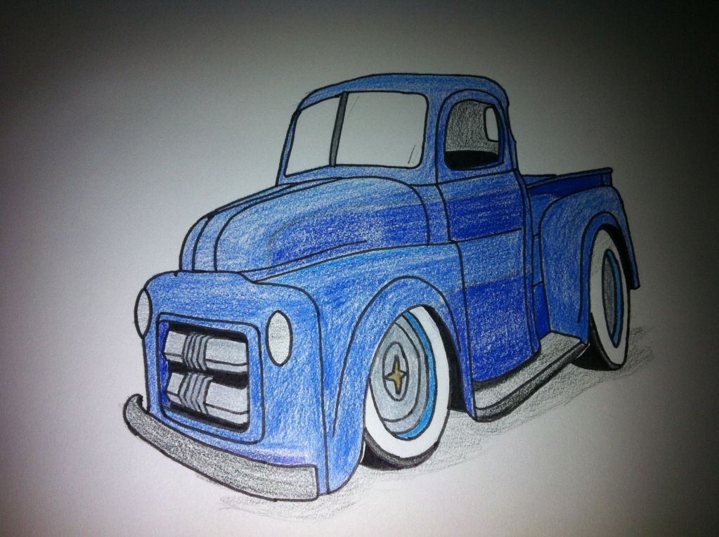

And also in case anyone was wondering or cares here is my final vision for the truck. I saw a piece that was done of another buddy's truck and did a rendition of my truck in the same style.

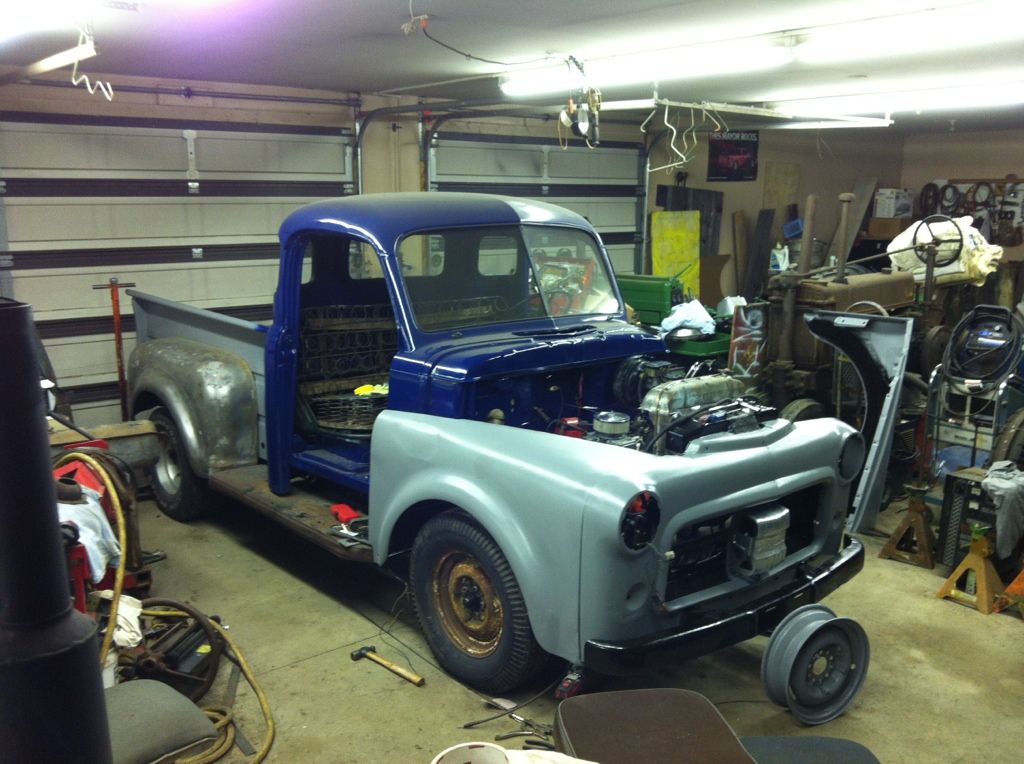

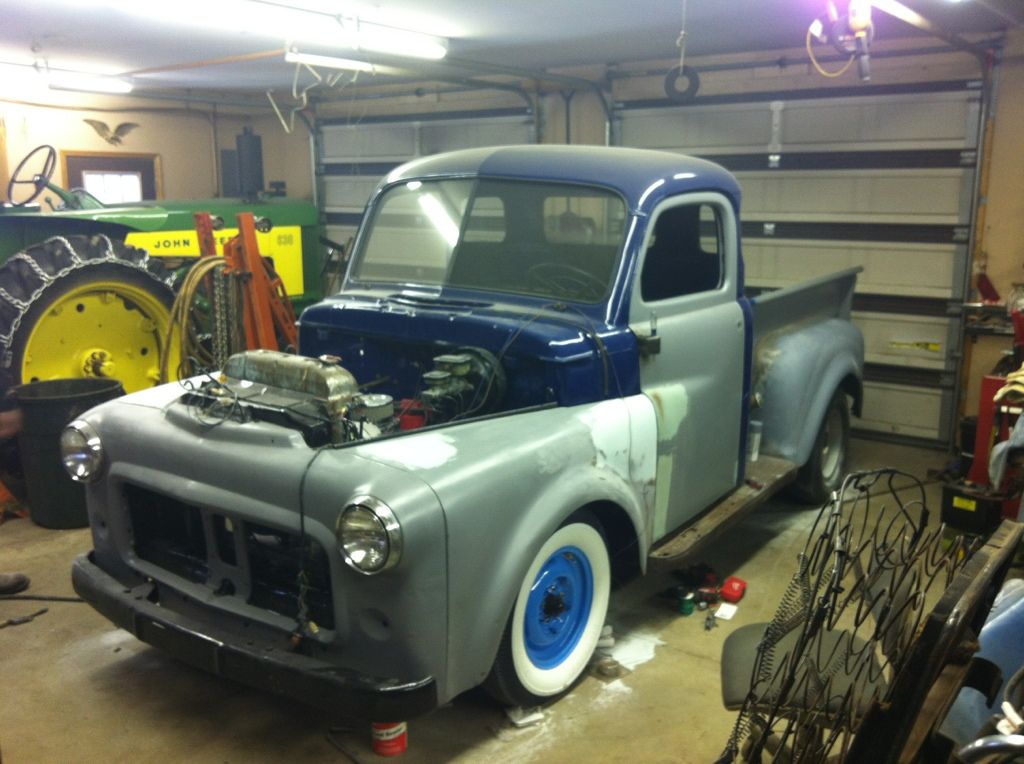

I've been busy... The stance is pretty much nailed at this point.
For some odd reason the passengers side rear is nearly 3 inches higher than the drivers side. I can't figure out why, I'm hoping the springs are just a little wonky and the frame isn't bent.
I'm going to be blowing the whole truck apart next week to do the body work and paint the bed, rear fenders, doors blue.
Hope you guys are still interested in this, its been real long since I've updated it.
