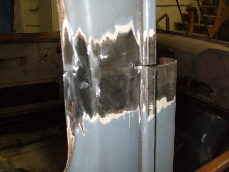

now it was time to take a little off the top. just two inches. and part it down the middle.
[img]RAPID'S 58 BIG WINDOW Dscf1012[/img][img]RAPID'S 58 BIG WINDOW Dscf1013[/img][img]RAPID'S 58 BIG WINDOW Dscf1111[/img][img]RAPID'S 58 BIG WINDOW Dscf1112[/img][img]RAPID'S 58 BIG WINDOW Dscf1113[/img][img]RAPID'S 58 BIG WINDOW Dscf1114[/img][img]RAPID'S 58 BIG WINDOW Dscf1115[/img][img]RAPID'S 58 BIG WINDOW Dscf1116[/img]

pillars are welded solid. next i'll make a filler for the roof, and put the door frames back together.
[img]RAPID'S 58 BIG WINDOW Dscf1117[/img][img]RAPID'S 58 BIG WINDOW Dscf1118[/img][img]RAPID'S 58 BIG WINDOW Dscf1119[/img]
