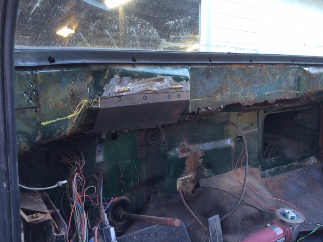

Update #2 - after the successful drive it was time to tackle the rusted out cowl; I started by disconnecting the battery and then set about taking the dash apart. I discovered that the foam components were/are complete dry rotted and destroyed and there is a fair amount of hacked wiring but overall not too bad. After getting the instrument cluster out, I began to try and figure out how to get the dash frame out and discovered 2 things; first they are completely hidden by the windshield gasket and second they had no intention of coming out by conventional means (aka screw driver). So, out came a plethora of tools to include a drill with many bits as well as my trusty dremel and carbide. After probably 4 hours of drilling, grinding, and prying it finally gave way and succumbed to my efforts. At that point I determined that I also would have to remove the heater which came with its own challenges as 2 of the mounting bolts did not want to come out. Finally, after a lot of work I got it all out and was able to really see what I had.
What I have is a completely rusted out cowl area running all the way across the cab. Evidentially water sat in this cowl for a very long time and this being Washington where it hardly ever rains (yes that is sarcasm) I suspect it stayed wet. I am not really sure how I am going to get it even remotely closed up but I will figure something out. I know one thing, I am going to dump a lot of MIG wire into this truck before it is done. [img]76 Dodge 700 Img_2311[/img]

The repair has begun. 76 Dodge 700 <a href=76 Dodge 700 Img_2412" />
