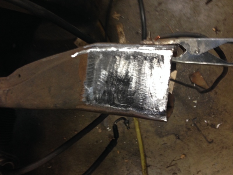

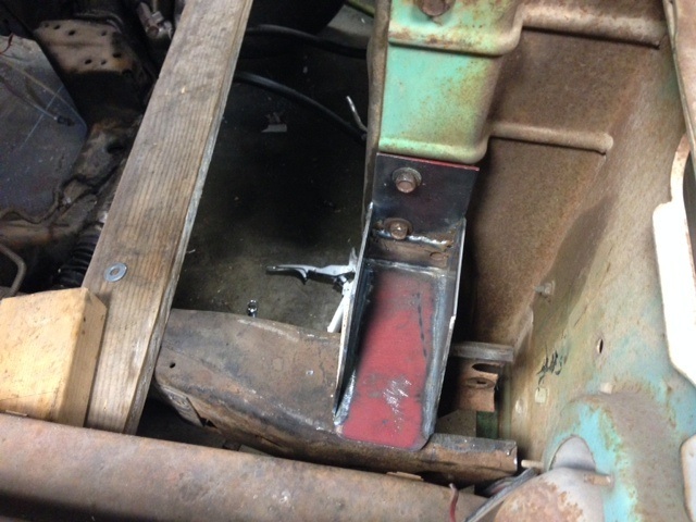

Post by FenderBender on Sat Feb 07, 2015 9:52 pm
Cut frame horns, removing Dakota radiator support holes, and evened up frame horns
Made new Radiator support brackets to work with new frame

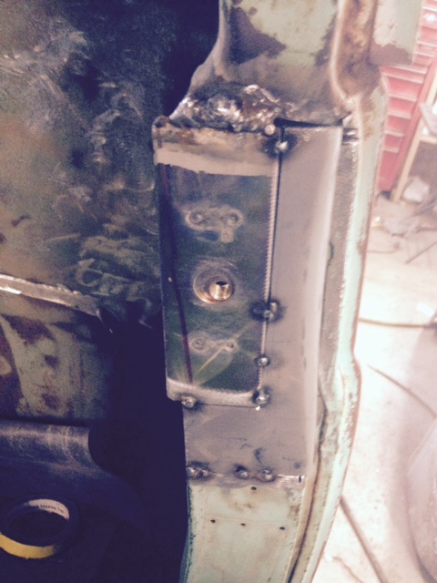

Post by FenderBender on Fri Feb 20, 2015 8:53 pm
Cab mounts complete along with Radiator support
