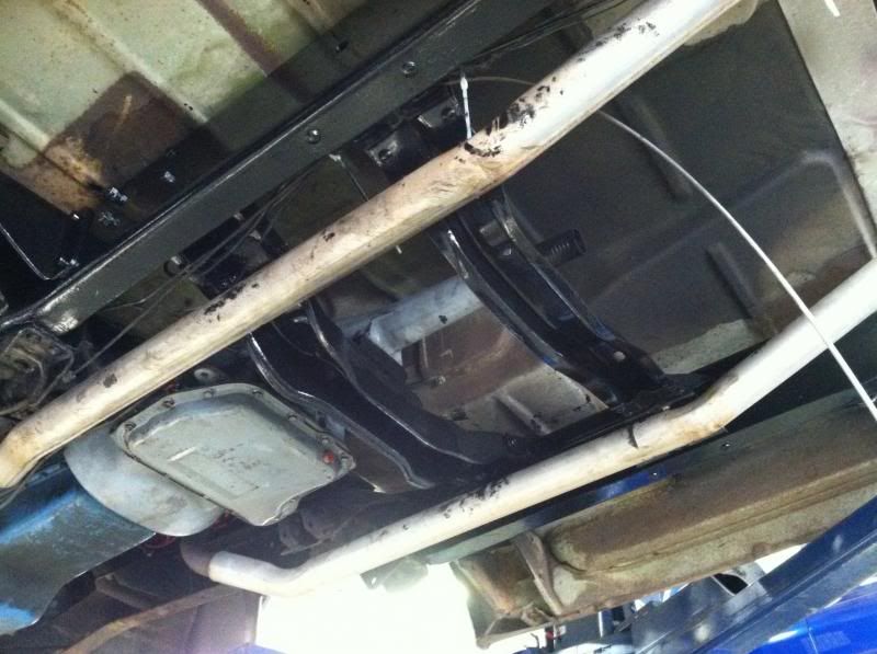

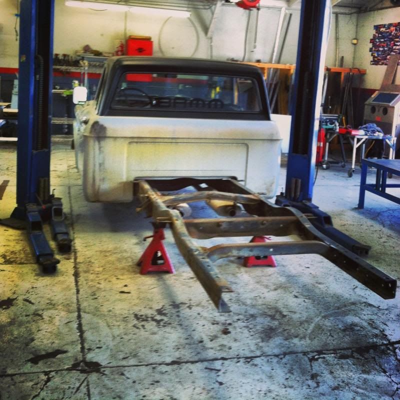

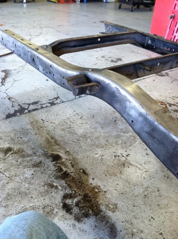

Stopped by the shop today to see all the air stuff getting mounted and the frame being boxed. I'm really liking how its all looking.

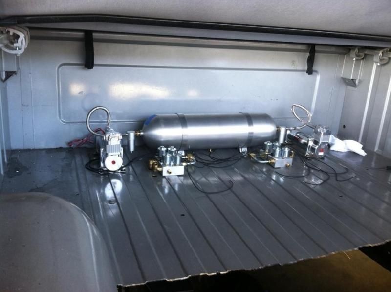

Post by BAMMD100 on Thu Oct 23, 2014 6:29 pm
Thanks!
It is called a 5 gallon tank but I believe the true capacity is actually less. Its pretty cool is seamless and made from spun aluminum.

Post by BAMMD100 on Tue Oct 28, 2014 9:58 pm
The air suspension on my truck got all hooked up and is functional. It just needs some brake work, wiring, and a little engine work and it will be back on the road. Hopefully by next week.
